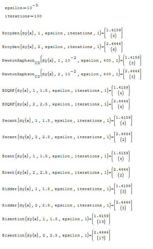

Here is another example I wanted to solve for a long time in SMath. Actually, you can not have a real numerical derivatives in SMath and I also mentioned that few times. If the expression is a bit more complex, there is quite a chance of getting into trouble with derivatives. Moreover, you can not find numerical derivatives of a spline function in SMath. Here is an example where I used Gradient.CD() from the BETANonlinearSolvers (see this thread - this plugin includes many other "derivative free" numerical procedures). I do not know any other more elegant way to solve these kind of problems in SMath. Although it was mentioned here BETANonlinearSolvers among many other things, I just put this example here because I wanted to get it into attention once more.

I do not know, sorry. It works for me. Actually, my point was that the differentiation in SMath is problematic - actually there is no pure numerical differentiation at all (there is a numerical integration procedure but SMath's symbolic engine does not have symbolical integration yet). If you want to solve a nonlinear equation, just use the mentioned plugin (SMath's solve() and roots() might give us a hedeack sometimes
