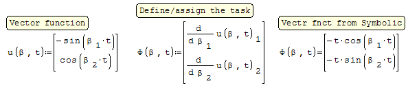

Hej i want to differentiate a unit vector like
I can only differentiate fx row 2 like this
Can anybody help, thanks

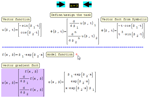

#2 Опубликовано: 16.02.2018 08:44:09
Hello [userlink]Danevangx[/userlink]
You can use the function vectorize(), a loop, or ranged indices... choose the one that fit your needs

#4 Опубликовано: 16.02.2018 11:21:08
This is NOT unit vector. My understanding is that you want
a general procedure to differentiate a function vector.
This simple demo procedure is the core algorithm in Smath fitting functions
1. Genfit ,,,, 2. linfiCheby

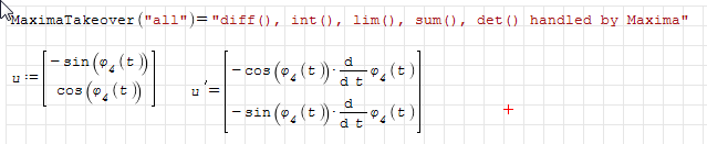

#5 Опубликовано: 16.02.2018 11:49:31
Here is another one. Maxima has generic vector-/matrix handling
diffm.sm (3,68 КиБ) скачан 1250 раз(а).
