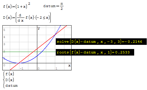

#2 Опубликовано: 11.04.2023 09:06:47
⚜ Kenny Lemens, P.E. ᵂᴵ
Greetings,
To obtain an answer, you are going to have to keep the boolean test out of your diff. equation.
Your equation would look similar to the following:

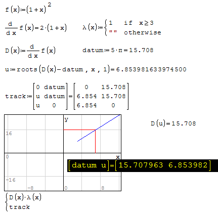

#8 Опубликовано: 11.04.2023 13:12:19
Your latest document is much different than your original.
The golden rule is to specify Bolean completely.
Sometimes it's immaterial ... One exception is DeBoor.

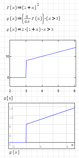

#9 Опубликовано: 11.04.2023 18:41:37
Hello everybody,
I have issues regarding diff function and boolean function.
I have been looking on different solution on the forum, but i have not found a related post.
How do you perform such calculation?
diff() function can't parse if original function has boolean expression.
Once derivative is completed result can be booleaned. (is this even a proper word )
Here how it is.

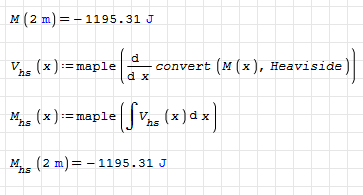

#10 Опубликовано: 11.04.2023 19:47:54
Do you have any idea on how to solve?
Yes. Use maple(diff(convert(M(x),Heaviside),x)) for convert SMath sign function into Maple Heaviside's. It looks ok now:
e7_5_3-hs ok.sm (139,5 КиБ) скачан 1325 раз(а).
