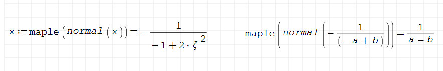

I want to get the real root in symbolic (in red frame) , but solve and maple solve always give me imaginary root (in blue frame).

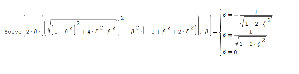

A simple option is force to find a real solution doing:
then...
best,
Oscar

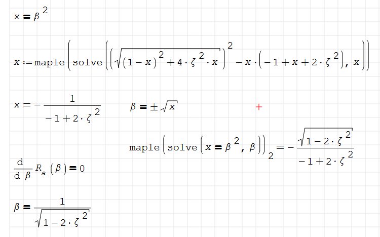

@Oscar Campo
I can't get answer as you show in the pic. Please see the attached.

Sometime I do so:
