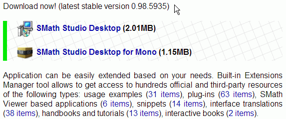

Looks attractive to update from 5346 to 5935 but risky from reading comments in this forum. From what I see here in this image are the MISSING step by step instructions:
1. How to evaporate Smath version previous to 5935 ?
2. How to install 5935
The procedure to evaporate I would attempt is quite standard:
a\. Uninstall 5346 from XP Uninstall program
b\. Delete all Smath 5346 folders from "Program File".
c\. There is no Smath to remove from the "registry.
Maths is not something one reads in diagonal, Smath as well when it comes
to "Update" or run new version. I will gladely read comments from actual 5935 users
that have switched from previous version and running fine all their work sheets
created in previous Smath version(s).
AND: no reply to the request for more than 5 messages when opening the forum.
Just answer either: not possible or "YES soon".... there is an answer not answered!
See what I meant from the "Download Smath Studio" ... missing instructions !

How to install 5935
It doesn't matter if you do a fresh install of SMath Studio or make an update - you should not have any instructions. All you need is provided by UI of MSI installer. That is it.
If there is anything unclear, I should fix it! There is nothing to discuss actually.

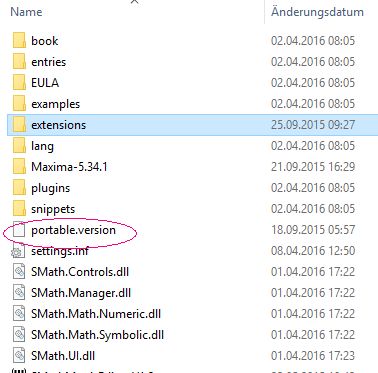

Hello Mike, Jean etc.
My way of testing new releases of SM is as follows:
For reasons of portabiliy I am using since years the "inofficial" portable version proposed by my namesake Martin Kraska.
This way all SM-files are stored in the SM-working directory (plugins, settings etc.)and nothing in any Windows subdirectory.
All you need is an empty file called portable.version in your SM_working directory.
@Andrey: Unfortunately this trick still does not work on my Linux system! : there the files are still stored in some hidden systemdirectory
Anyway, on windows:
1. just copy the whole working SM-directory of your old "portable" version to a new one.
2. download and unpack the LINUX .tar.gz file of the new release and overwrite all existing files in your newly created directory.
Now you have two different active versions (with identical settings and plugins) which can simply be starded by doubleclick on the appropriate icon.
Martin

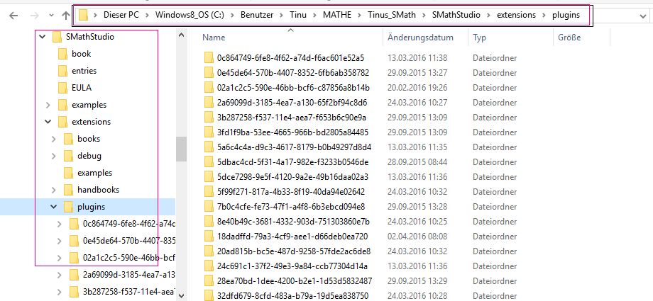

Jean: IMHO you are actually using a mix of two versions (mickmack?).
Цитата
I have two icons to open Smath 5346. One opens a non installed Smath
directly from C:\ Smath+Maxima and one that opens installed Smath from
C:\Program Files. Their diretory are same top to botom, all items.
This can't be true. All systemfiles of the official windows installation (C:Program Files) should be in a directory called something like this:
C:\Users\YOUR NAME\AppData\Roaming\SMath
On the "portable" installation the corresponding files are in the working directory. I.e. all plugins etc. must be installed separately for both versions. The LINUX_file contains no third party plugins, they must be installed/updated inside portable SM via plugin manager.
Your portable directory must contain its own system files i.e. the complete subdirectory "extensions".
