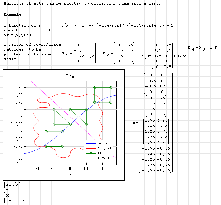

You can compute the moment/axial force pairs individually, append them to a 2 column matrix and plot that matrix. Best results are obtained with the X-Y-Plot plugin by Viacheslav N. Mezentsev (uni).

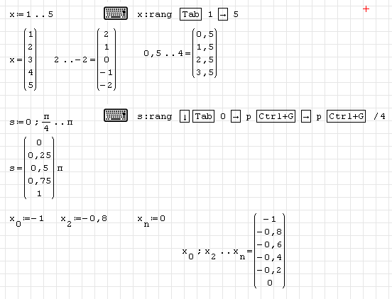

Second, quick question, in the 'for' statement shown above (for i from 1 to n+1) how do you get the two periods (the "to" part of it)? What keys are pressed?
#4 Опубликовано: 14.11.2013 02:21:07
a..b is the operator form of the function range(a,b).
