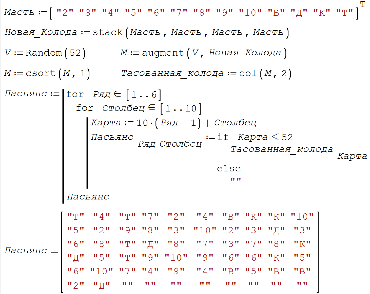

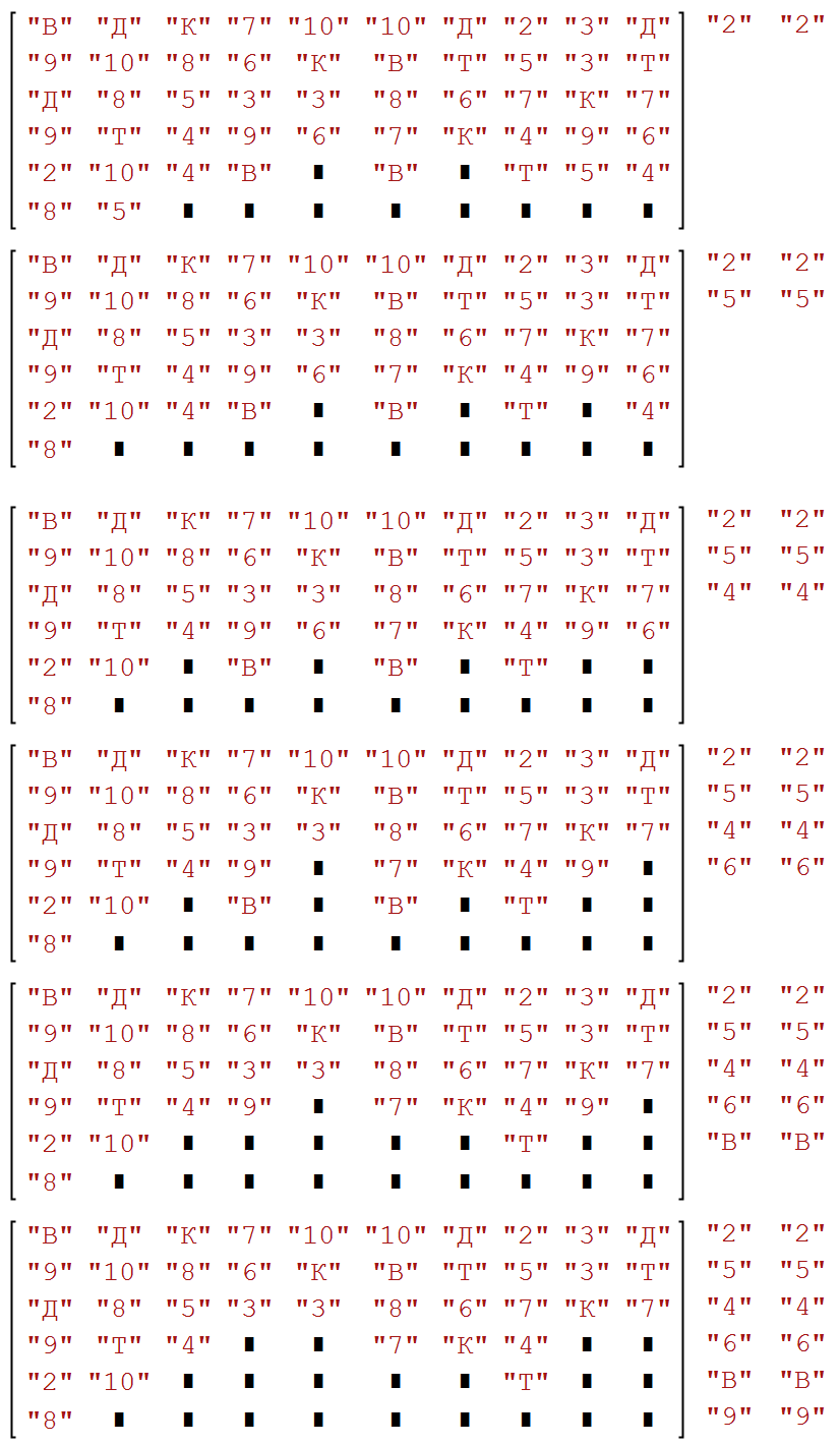

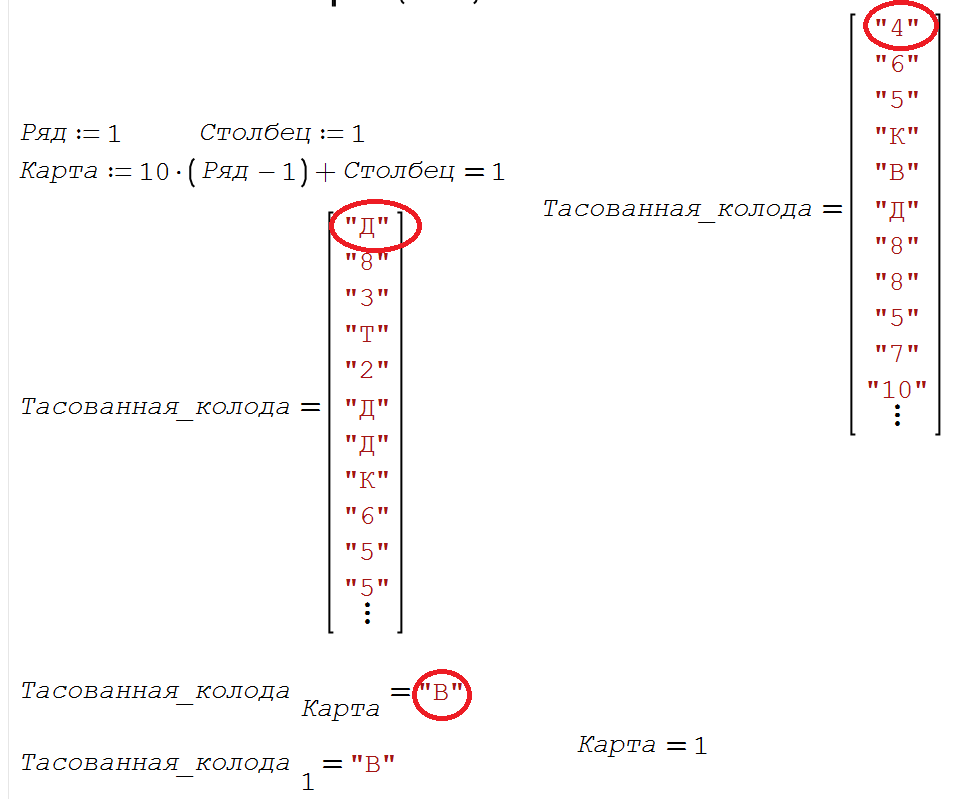

What is it with vector?
Patience.sm (37,01 КиБ) скачан 1475 раз(а).
#2 Опубликовано: 27.07.2024 23:05:39
Valery Ochkov
Valery Ochkov
Sorry!
It is one strange bug, I think.
Without the program - all ok!
Patience.sm (37,01 КиБ) скачан 1476 раз(а).

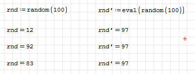

I wasn't able to reproduce the error, but it appears as if the Random() function is somehow redefining your variable every time you call "Тасованная_колода" to display.
May this be of Good Help;
⚜ Kenny Lemens, P.E. ᵂᴵ
#4 Опубликовано: 07.08.2024 20:11:42
Hi. It's not a bug, but a feature. Use eval to pin up the function value.
