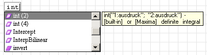

I don't see anything related to calculus.
#2 Опубликовано: 08.05.2014 03:01:01
OK, let's try happy guessing based on near to zero information about what you actually see and what you expect.
You might try to type int or diff and see what choices the dynamic assistant can offer.
