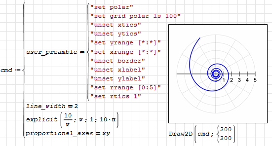

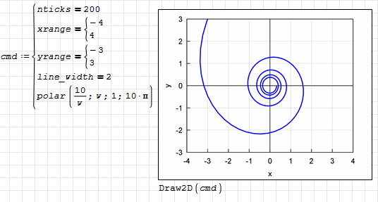

#3 Posted: 7/26/2024 6:35:37 AM
This is how it can be done using Maxima. Full flexibility is gained using direct gnuplot commands.
Draw2D3D-EN.sm (1017.89 KiB) downloaded 1602 time(s).
SMath with Maxima.pdf (3.5 MiB) downloaded 4337 time(s).
