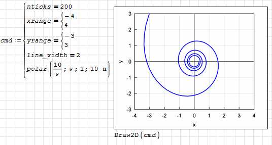

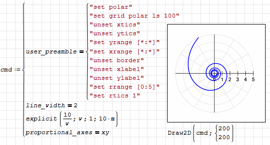

This is how it can be done using Maxima. Full flexibility is gained using direct gnuplot commands.
Draw2D3D-EN.sm (1017,89 КиБ) скачан 1602 раз(а).
SMath with Maxima.pdf (3,5 МиБ) скачан 4337 раз(а).
