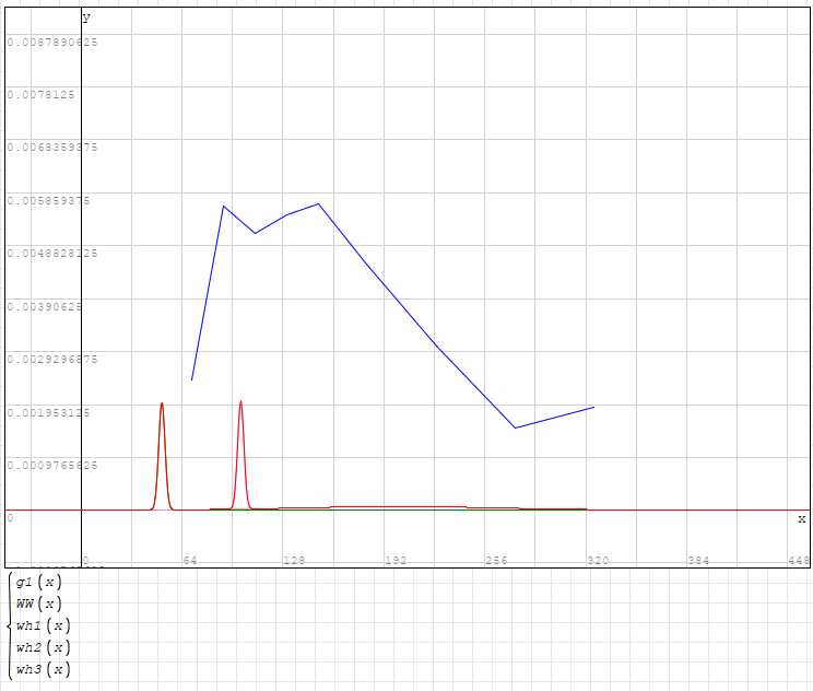

There, for some reason, the search of options stopped at the value of hh1 = 0.01, respectively, and hh2 = 001, hh3 = 0.01. That is, h1, h2, and h3 were only checked when the value =1.
Whereas I expected that the iteration of options should reach hh1 = hh2 = hh3 = 1, respectively h1 = h2 = h3 = 100.
For other parameters, it also seems that the search for options has not reached the end.
That is why the resulting graph shows a complete mismatch between the original data and the approximating formula.

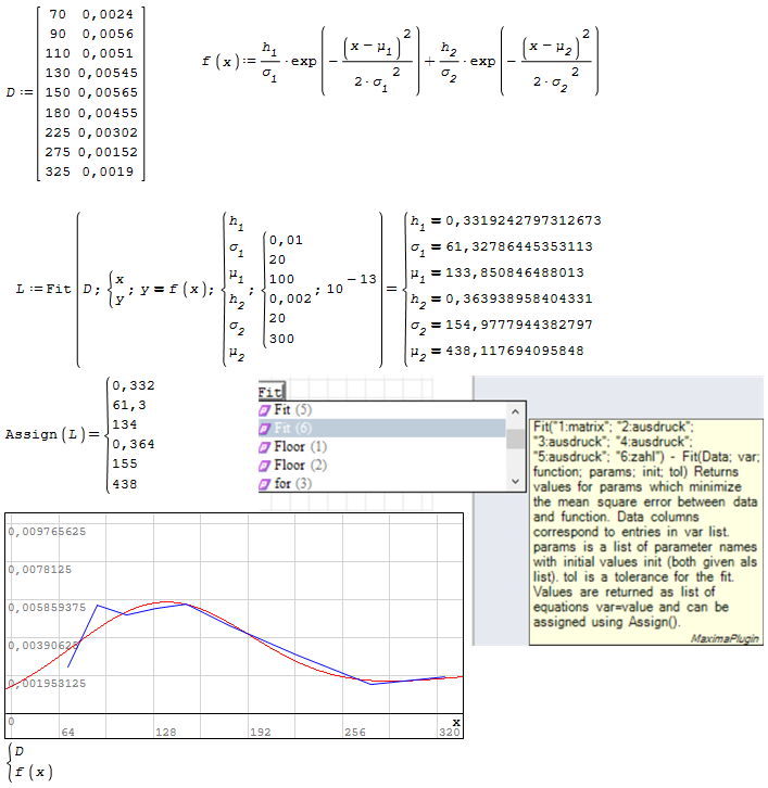

Hi. Some notes attached.
eng-min.sm (44.48 KiB) downloaded 1111 time(s).
eng-min.pdf (382.41 KiB) downloaded 756 time(s).

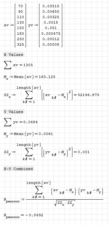

Below you can find how to calculate Pearson correlation coefficient.
To sum all elements of a vector, you can use sum(1).
To operate piecewise you can use sum(4).
You can also use for-loop and while() to calculate something in a vector/matrix. Not demonstrated here.
pearson.sm (8.9 KiB) downloaded 1130 time(s).
