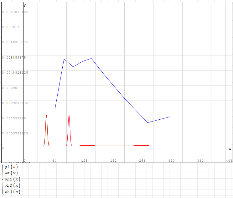

There, for some reason, the search of options stopped at the value of hh1 = 0.01, respectively, and hh2 = 001, hh3 = 0.01. That is, h1, h2, and h3 were only checked when the value =1.
Whereas I expected that the iteration of options should reach hh1 = hh2 = hh3 = 1, respectively h1 = h2 = h3 = 100.
For other parameters, it also seems that the search for options has not reached the end.
That is why the resulting graph shows a complete mismatch between the original data and the approximating formula.
I don't have an error in the If statement?
There I put continue in the else field.
eng-min.sm (32,5 КиБ) скачан 1076 раз(а).

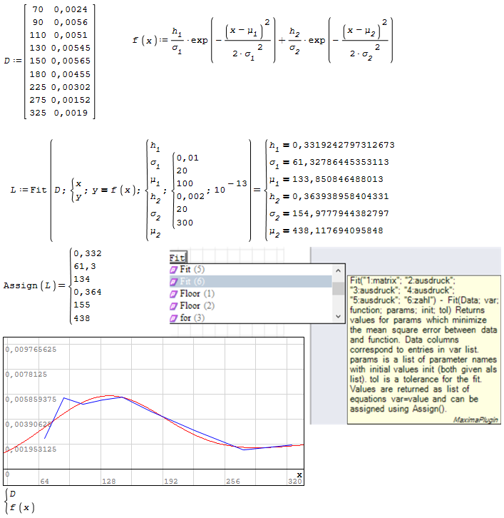

Hi. Some notes attached.
eng-min.sm (44,48 КиБ) скачан 1111 раз(а).
eng-min.pdf (382,41 КиБ) скачан 756 раз(а).

I decided to take a simpler case for now, when we approximate the sum of two distributions.
With some tweaks, the time limit can be circumvented. Although I haven't tried the Fit function yet. Perhaps it will give you a gain in time.
Can you tell me how to limit the accuracy of the calculations? There Sq is calculated with an accuracy of 15 decimal places, while 9 digits are quite enough for me. This would give you a gain in time.
The approximation is quite satisfactory. The defined integral differs from the original value by only 1.5%. Given that the raw data is quite rough, there is actually a histogram, this is quite acceptable.
But I still need to calculate the Pearson correlation coefficient, and I'm faced with the fact that the reference book does not specify how to find the sum of the elements of any vector. Can you tell me what you can do in this case?
Pirson-0.sm (14,55 КиБ) скачан 1133 раз(а).

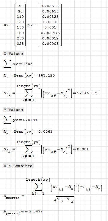

Regards.
Below you can find how to calculate Pearson correlation coefficient.
To sum all elements of a vector, you can use sum(1).
To operate piecewise you can use sum(4).
You can also use for-loop and while() to calculate something in a vector/matrix. Not demonstrated here.
pearson.sm (8,9 КиБ) скачан 1130 раз(а).

Dear Martin Kraska
I tried to compose the solution as you suggested.
But for some reason, the program gives an error.
In addition, I have a question – you suggested a solution when the approximation is based on the sum of two normal distributions.
And in my source data, this does not always happen. It is often necessary to look for an approximation by the sum of the three distributions.
Will this increase the calculation time to inconvenient values?
Fit-1.sm (10,39 КиБ) скачан 1076 раз(а).
