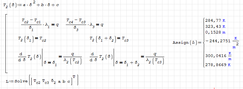

I am trying to plot a temperature field in a three layer wall. There is no problem with the outer layers. But there is a problem in the middle layer - there should be a parabola, not a straight line. How to draw this parabola in the simplest way - with one formula. I know the hard way.

#4 Posted: 7/15/2023 7:17:49 AM
1226 likes in 2151 posts.
Don't know if that is the simplest solution.
Stenka-3-eng.sm (58 KiB) downloaded 60 time(s).

Valery Ochkov 7/15/2023 7:25:00 AM

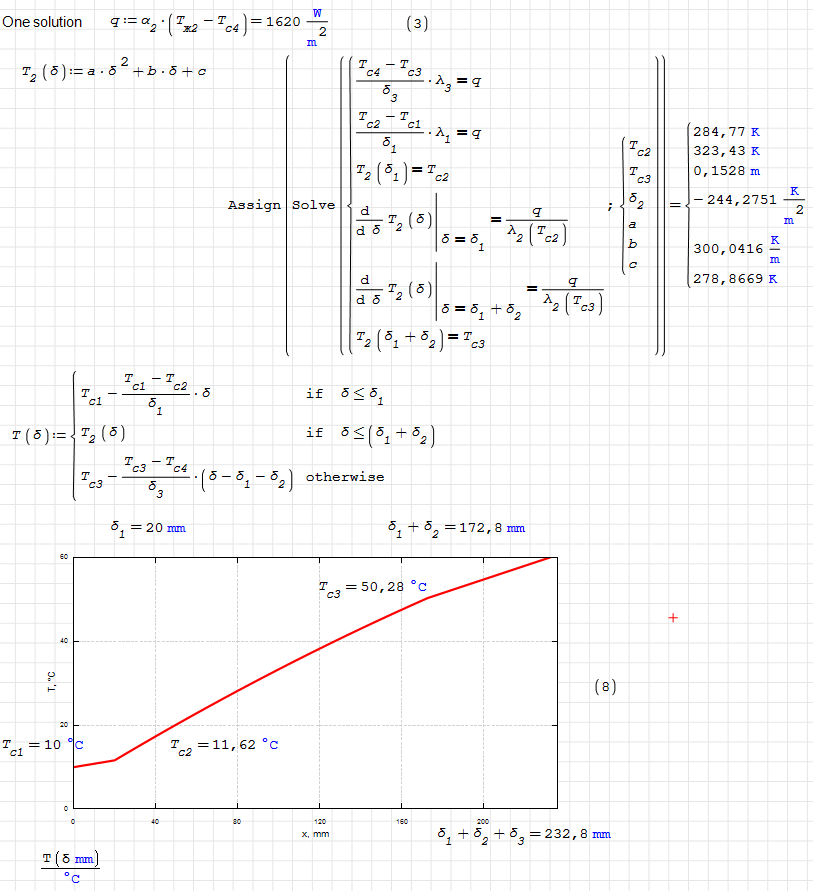

Version with mathcad block to collect the equations
Stenka-3-eng1.sm (59 KiB) downloaded 68 time(s).

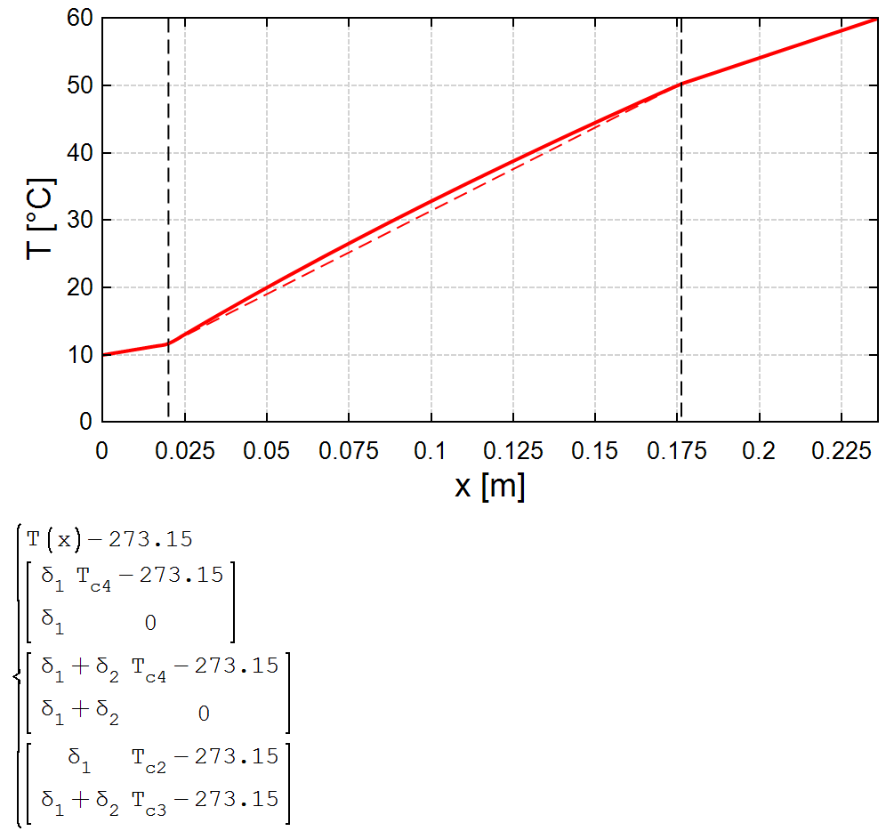

#7 Posted: 7/15/2023 9:13:21 AM
983 likes in 6866 posts.
1. Three layers linear from min(x).
2. NON-linear from experimental
... project done Mathsoft Collaboratory.
Make the first & third segments linear.
The two documents sanity checked Smath Solver 30405.
Cheers ... Jean.
Maths min(x),max(x).sm (22 KiB) downloaded 63 time(s).
0Appendix_1 Thermal Insulation.sm (10 KiB) downloaded 62 time(s).

One solution from Alan Stevens
Stenka-3-Alan.sm (60 KiB) downloaded 63 time(s).
