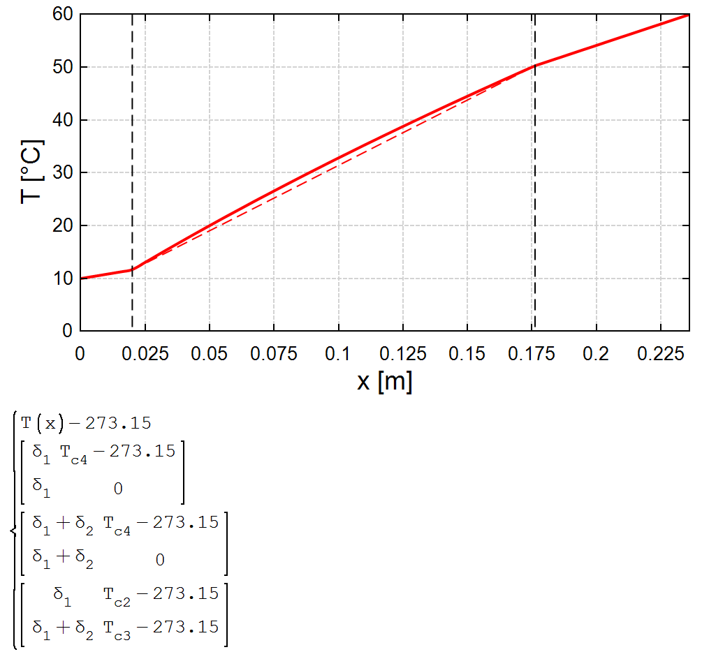

#4 Опубликовано: 15.07.2023 07:17:49
Don't know if that is the simplest solution.
Stenka-3-eng.sm (58,13 КиБ) скачан 1320 раз(а).
Valery Ochkov 15.07.2023 07:25:00

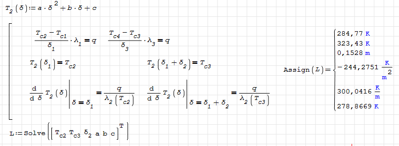

#6 Опубликовано: 15.07.2023 07:32:04
Version with mathcad block to collect the equations
Stenka-3-eng1.sm (59,5 КиБ) скачан 1341 раз(а).
Valery Ochkov 15.07.2023 07:40:00

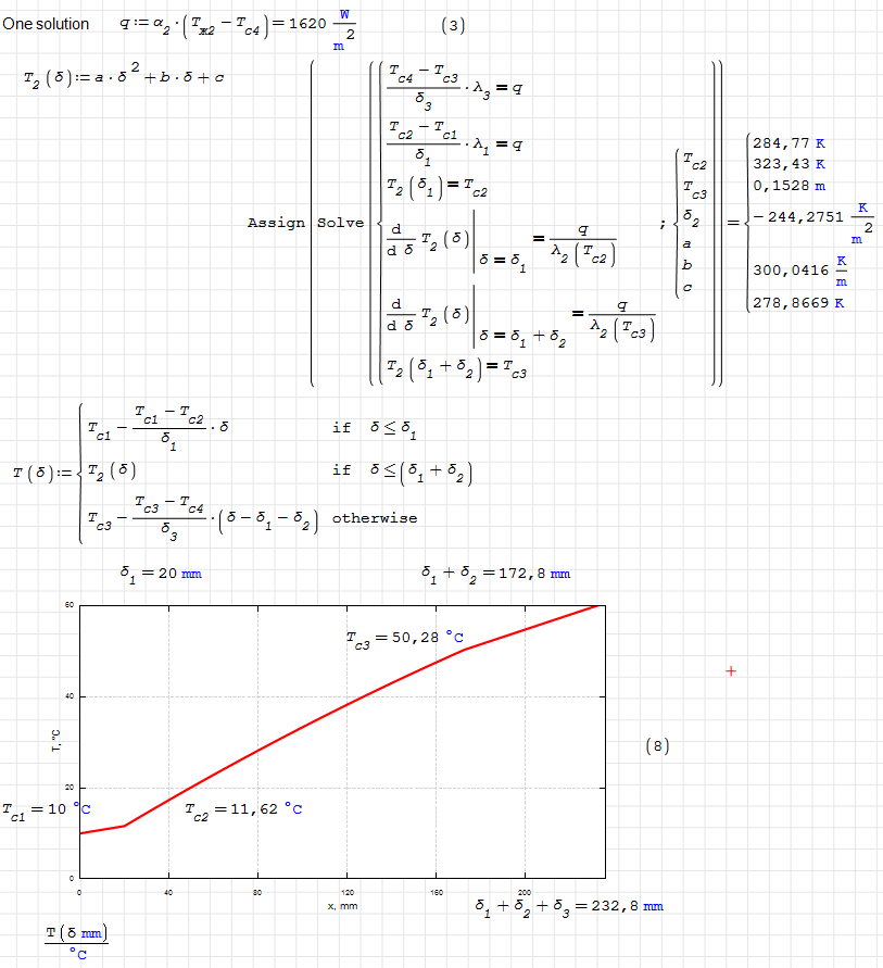

#8 Опубликовано: 16.07.2023 05:40:21
Valery Ochkov
Valery Ochkov
I am trying to plot a temperature field in a three layer wall. There is no problem with the outer layers. But there is a problem in the middle layer - there should be a parabola, not a straight line. How to draw this parabola in the simplest way - with one formula. I know the hard way.
Stenka-3-eng.sm (60,64 КиБ) скачан 1325 раз(а).
One solution from Alan Stevens
Stenka-3-Alan.sm (60,35 КиБ) скачан 1298 раз(а).
