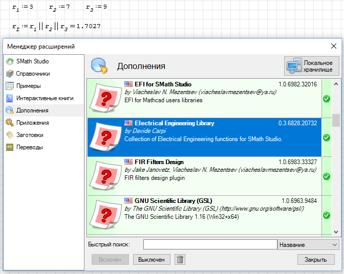

Hello,i have r1=3 r2=7 r3=9
is the some operator that will do the parallel operator?
1/rt =1/r1 +1/r2 +1/r3
Thanks
#2 Posted: 5/29/2019 7:45:11 AM
1403 likes in 1708 posts.
EEL_Rpar() function from the Electrical Engineering Library:
r.Σ:EEL_Rpar(r.1,r.2,r.3)

#5 Posted: 5/30/2019 11:20:02 AM
Oscar Campo
Oscar Campo
124 likes in 298 posts.
Sorry, I don't understand parallel operator.
This operator let's you calculate the total resistance of resistances in parallel

#6 Posted: 5/31/2019 11:59:35 AM
Arie
Arie
93 likes in 285 posts.
More explicitly...
