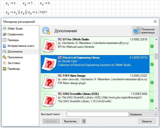

Hello,i have r1=3 r2=7 r3=9
is the some operator that will do the parallel operator?
1/rt =1/r1 +1/r2 +1/r3
Thanks
#2 Опубликовано: 29.05.2019 07:45:11
EEL_Rpar() function from the Electrical Engineering Library:
r.Σ:EEL_Rpar(r.1,r.2,r.3)

#5 Опубликовано: 30.05.2019 11:20:02
Oscar Campo
Oscar Campo
124 сообщений из 298 понравились пользователям.
Sorry, I don't understand parallel operator.
This operator let's you calculate the total resistance of resistances in parallel
Arie 31.05.2019 12:00:00
#6 Опубликовано: 31.05.2019 11:59:35
Arie
Arie
93 сообщений из 285 понравились пользователям.
More explicitly...
sergio 01.06.2019 12:53:00, NDTM Amarasekera 01.06.2019 15:23:00
#7 Опубликовано: 01.06.2019 12:25:57
Thanks alyles for the dual resistance operator explanation,
i.e: series/parallel ... both ways ... Jean
