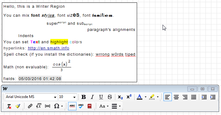

WYSIWYG word processing for your worksheets :d
>>> PLEASE REPORT IN THIS TOPIC ANY ISSUE, MORE DETAILED AS POSSIBLE <<<
