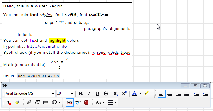

WYSIWYG word processing for your worksheets :d
>>> PLEASE REPORT IN THIS TOPIC ANY ISSUE, MORE DETAILED AS POSSIBLE <<<
TODO LIST
  • Evaluable regions;
  • Styles (full implementation requires API improvements to get/set worksheets properties);
  • RTL/LTR support (see Unicode Bidirectional Algorithm);
  • new/alternative Hunspell wrapper (NHunspell no more updaqted, latest sources not available);
  • tables;
OLD documentation:
