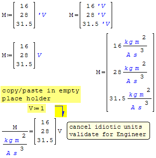

I read some post about units, but my problem occurs only for Vector / matrix.
If a declare a Matrix : P28V with three values (16V, 28V and 31.5V) and I want to display the result, the unit will be for each result : kg*m²/(A*s^3)
Units in matrix
Are there some restriction about it?
For each Matrix that I used, I have to specify each time the unit (like V, mA) instead of the bigger one

kg*m²/(A*s^3)
What does that mean to the Electrician measuring 735 000 volts ?
A good way to get rid of those stupidities: make units silent

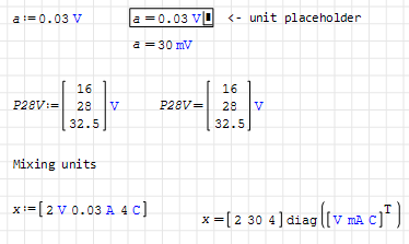

You can use the "unit placeholder" for display in the desired unit. Also can display several units for the same vector.

I understant I can change the unit manually to have the desired one.
But it not optimized especially for the vector, each time I have to changed the unit manually. If all the data on the vector have differents units, it take some times.
