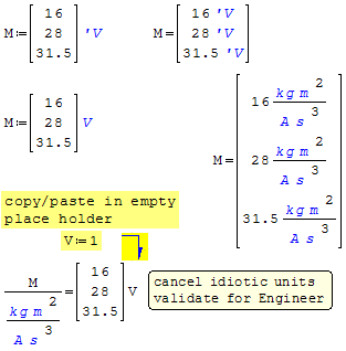

I read some post about units, but my problem occurs only for Vector / matrix.
If a declare a Matrix : P28V with three values (16V, 28V and 31.5V) and I want to display the result, the unit will be for each result : kg*m²/(A*s^3)
Units in matrix
Are there some restriction about it?
For each Matrix that I used, I have to specify each time the unit (like V, mA) instead of the bigger one

#2 Опубликовано: 06.01.2022 10:01:50
kg*m²/(A*s^3)
What does that mean to the Electrician measuring 735 000 volts ?
A good way to get rid of those stupidities: make units silent

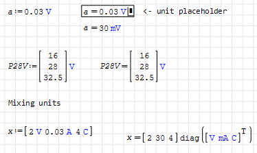

#4 Опубликовано: 06.01.2022 14:21:31
You can use the "unit placeholder" for display in the desired unit. Also can display several units for the same vector.
Another feature, I read a topic about it but without enough explanation. It could be very practical to have automatically the appropriate units factor (M,k, , m, µ, n) before the units.
Yes. Or at least an ENG notation mode, like in the calculators, with scientific notation but with exponents multiples of three.
