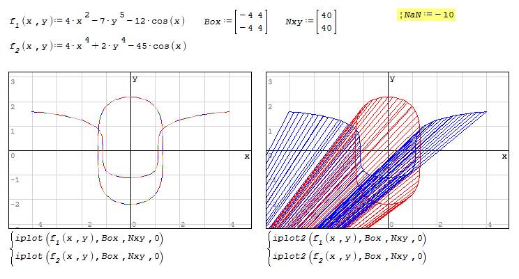

Hi. I'm trying to implement this implicit plot. But can't "cut" the lines in the xy plot. Also, any help about speeding the function is welcome.

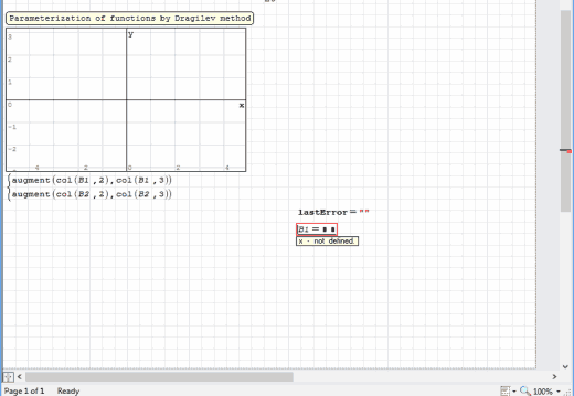

Hello Alvaro:
Thank you very much.
The error in the graph is that x is not defined.
What causes this error?
In the graphs published by you it is seen that graphs correctly.

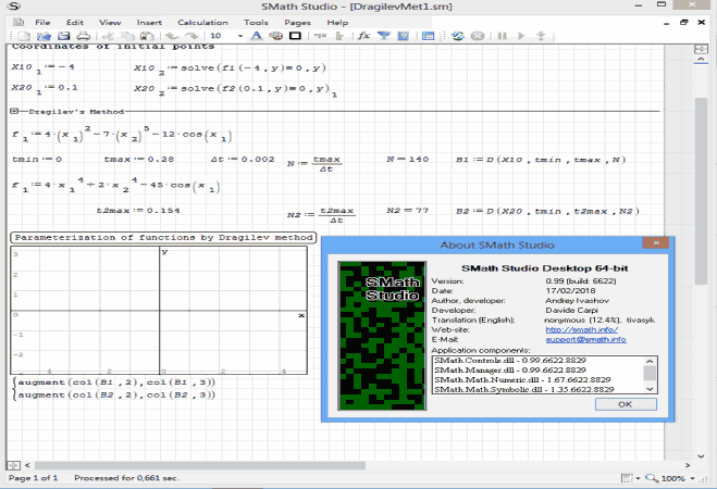

Hola Carlos. Try the following, a short version, just for n=2.
DragilevMet2.sm (12 KiB) downloaded 85 time(s).

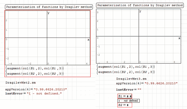

Hola Alvaro, Hello Ber7,
Thanks for your reply, but the DragilevMet2 and 3 files do not work.
The file of Ber 7 does not show any error, but by requiring the value
of B1 and B2, it says that "x" is not defined.
Attached drawing of the errors.

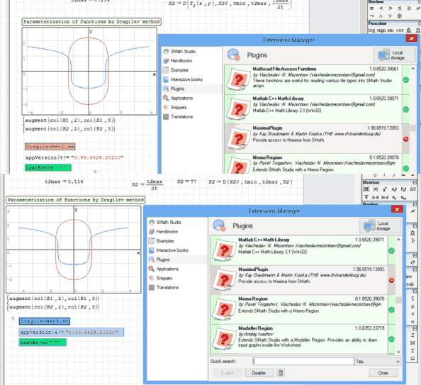

Thanks for your answer, but I found the fault.
The interference is caused by the Maxima Plugin,
by disabling it, the file works correctly.
