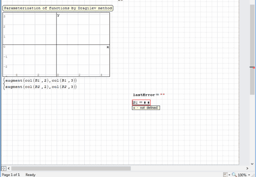

#6 Опубликовано: 19.02.2018 19:22:41
CBG
CBG
77 сообщений из 312 понравились пользователям.
Not graphic
It does not show any error
Carlos
#7 Опубликовано: 19.02.2018 21:28:12
Alvaro Diaz Falconi
Alvaro Diaz Falconi
Hi Carlos
For see the error message type B1=

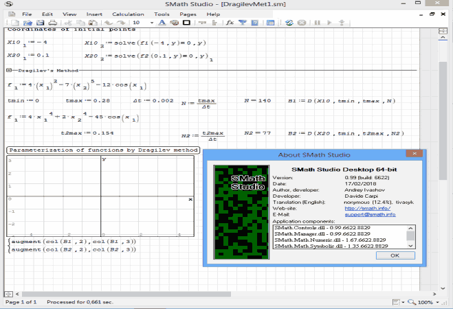

#8 Опубликовано: 19.02.2018 23:44:57
CBG
CBG
Hello Alvaro:
Thank you very much.
The error in the graph is that x is not defined.
What causes this error?
In the graphs published by you it is seen that graphs correctly.
Carlos

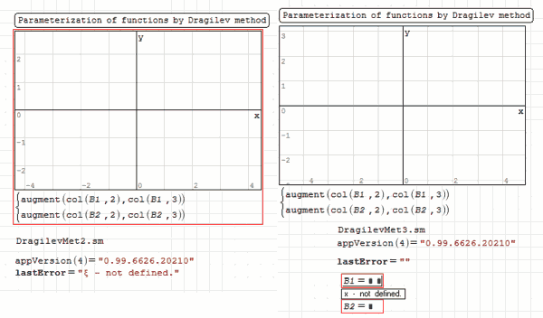

By--> Razonar
Цитата
Hola Carlos. Try the following, a short version, just for n=2
By--> Ber7
Цитата
Try also the old version of the Dragilev method
DragilevMet3.sm (24kb) downloaded 10 time(s)
Hola Alvaro, Hello Ber7,
Thanks for your reply, but the DragilevMet2 and 3 files do not work.
The file of Ber 7 does not show any error, but by requiring the value
of B1 and B2, it says that "x" is not defined.
Attached drawing of the errors.
Hello Jean, your files worked perfectly.
Carlos

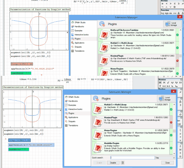

#14 Опубликовано: 23.02.2018 15:56:57
CBG
CBG
Hola Alvaro:
Gracias por tu respuesta.
Thanks for your answer, but I found the fault.
The interference is caused by the Maxima Plugin,
by disabling it, the file works correctly.
Carlos
