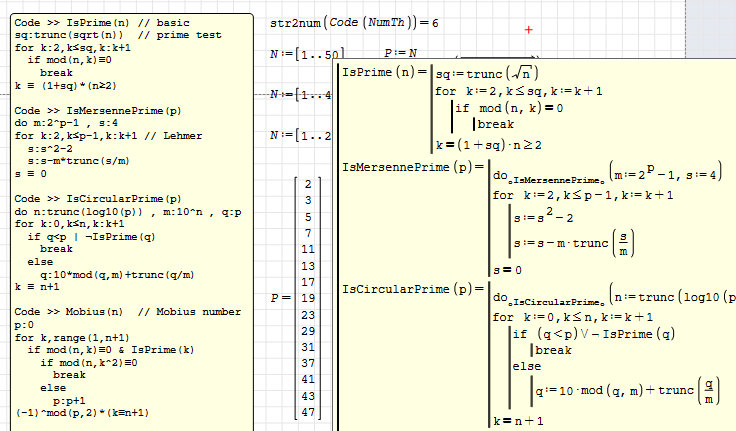

This function take the script in the variable description and try to convert it into a SMath function.

Updated for if(2), if(3) and if(4).

Updated. Some few new features added.
