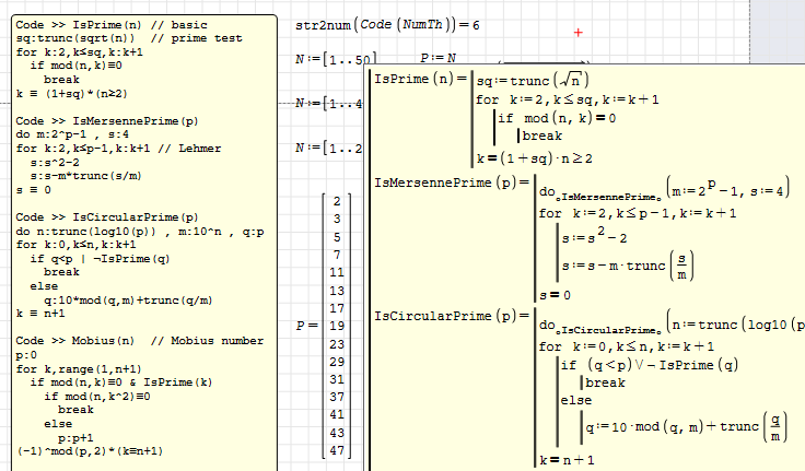

This function take the script in the variable description and try to convert it into a SMath function.
Code.sm (43 КиБ) скачан 165 раз(а).
Code.pdf (185 КиБ) скачан 202 раз(а).

Updated for if(2), if(3) and if(4).
Code.sm (58 КиБ) скачан 112 раз(а).
Code.pdf (244 КиБ) скачан 127 раз(а).

Updated. Some few new features added.
Code.pdf (606 КиБ) скачан 97 раз(а).
Code.sm (111 КиБ) скачан 93 раз(а).
