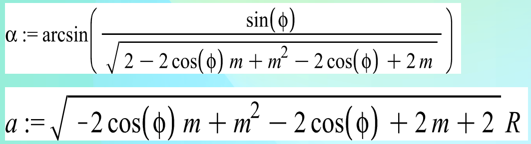

My friend use Maple to get symbolic solution like this
You can see that in the solution of alpha, there is no a, in the solution of a, there is no alpha.

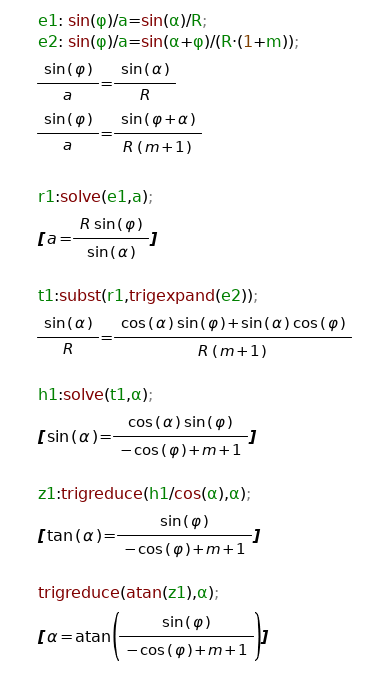

Here is α solved symbolically in wxMaxima.
Same method can be applicable for variable a.
untitled.wxmx.zip (1 KiB) downloaded 64 time(s).

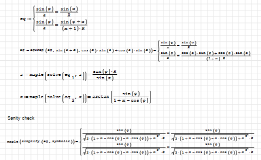

In the example below, I solved your function with Maple.
Though it gives the results correct, result matrix is cripled.
Copying and changing last bits of result ";2;1)" to ";2;2)" will correct the result.
";" may differ to "," according to your arguments separator.
Worksheet1.sm (15 KiB) downloaded 98 time(s).

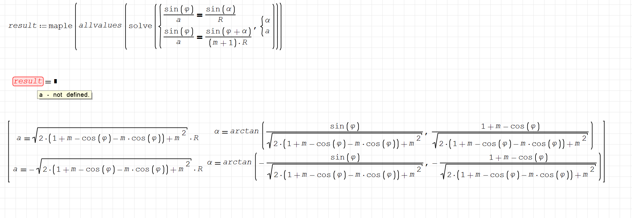

Hi overload,
When I open you sm I get this error
#9 Posted: 4/16/2022 9:57:28 AM

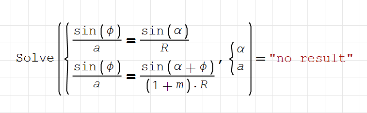

No
The two equations should be put in one system.
#10 Posted: 4/16/2022 12:26:22 PM
churichuro
churichuro
28 likes in 79 posts.
Is Maple plugin in Smath able to get symbolic results as Maxima does, but more
Hi overload,
appears in red, because the evaluation must be symbolic.
select the "result" variable, press the right button and in the type of evaluation select symbolic and that's it.
I hope I have served you, greetings

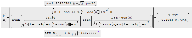

#12 Posted: 4/17/2022 8:32:35 AM
983 likes in 6866 posts.
Thanks Jean,
Both beta and alpha are unknown.
the result of beta and alpha still include these unknowns.
Onlyφ, R and m are known and can be used in the results.
... to be used as productive.
Your system is baby stuff, example 2 advanced.
I leave it there, not knowing more about your end demand.
Simply a solved formula representation ???
Comment or ignore ... Jean.
Solve ADVANCED Productive.sm (22 KiB) downloaded 69 time(s).
