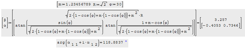

Thanks Jean,
Both a and alpha are unknows.
the result of a and alpha are still includes these unknows.
Only φ, R and m are knowns and can be used in the results.

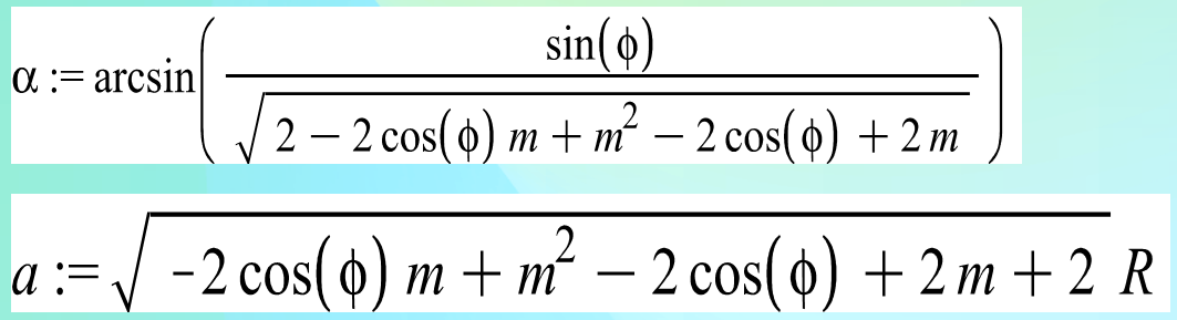

Thanks Jean,
Buy you 2nd sybolic solution is the same as the 1st one.
The solution should not include the unknow a and alpha
My friend use Maple to get symbolic solution like this
You can see that in the solution of alpha, there is no a, in the solution of a, there is no alpha.

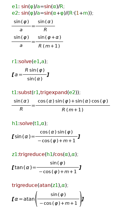

#4 Posted: 2/20/2022 8:29:51 PM
598 likes in 1,380 posts.
Symbolic solver of maxima is not that capable.
As far as I know of course, maybe there is a simpler way.
But this statement was what I had read about it.
You have to use some substitutions for that solutions.
And some extra division, arc functions, visa versa.
Here is α solved symbolically in wxMaxima.
Same method can be applicable for variable a.
untitled.wxmx.zip (1.6 KiB) downloaded 363 time(s).

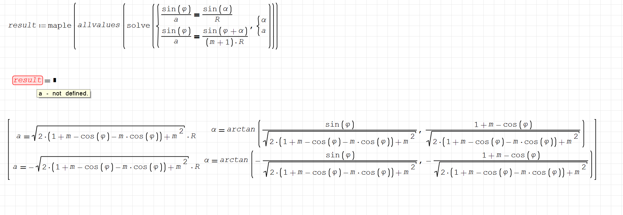

Is Maple plugin in Smath able to get symbolic results as Maxima does, but more easily?
#7 Posted: 2/22/2022 11:55:34 AM
Maple is easier to use, that is a fact.
And sometimes it gives better results.
But Maxima can surpass Maple at certain aspects.
Use what suits your needs most.
In the example below, I solved your function with Maple.
Though it gives the results correct, result matrix is cripled.
Copying and changing last bits of result ";2;1)" to ";2;2)" will correct the result.
";" may differ to "," according to your arguments separator.
Worksheet1.sm (15.97 KiB) downloaded 1245 time(s).

Hi overload,
When I open you sm I get this error
#9 Posted: 4/16/2022 9:57:28 AM
netsonicyxf

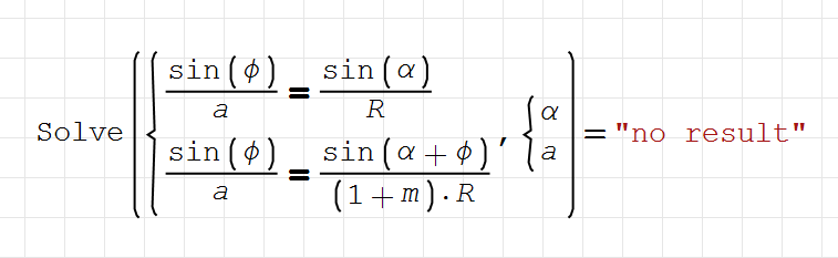

... is that what you are looking for ?
No
The two equations should be put in one system.
Hi overload,
appears in red, because the evaluation must be symbolic.
select the "result" variable, press the right button and in the type of evaluation select symbolic and that's it.
I hope I have served you, greetings

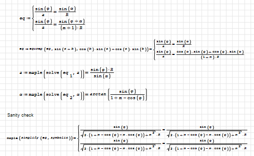

Hi. Another way, applying trigonometric identities.
solve_trig.sm (12.03 KiB) downloaded 1194 time(s).
Addition to churichuro's reply, use this simple function to correct maple plugin result matrices.
maplecorrect.sm (26.79 KiB) downloaded 1773 time(s).
