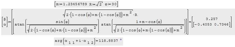

Thanks Jean,
Both a and alpha are unknows.
the result of a and alpha are still includes these unknows.
Only φ, R and m are knowns and can be used in the results.
Symbolic solver of maxima is not that capable.
As far as I know of course, maybe there is a simpler way.
But this statement was what I had read about it.
You have to use some substitutions for that solutions.
And some extra division, arc functions, visa versa.
Here is α solved symbolically in wxMaxima.
Same method can be applicable for variable a.

Is Maple plugin in Smath able to get symbolic results as Maxima does, but more easily?
WroteIs Maple plugin in Smath able to get symbolic results as Maxima does, but more easily?
Maple is easier to use, that is a fact.
And sometimes it gives better results.
But Maxima can surpass Maple at certain aspects.
Use what suits your needs most.
In the example below, I solved your function with Maple.
Though it gives the results correct, result matrix is cripled.
Copying and changing last bits of result ";2;1)" to ";2;2)" will correct the result.
";" may differ to "," according to your arguments separator.
Worksheet1.sm (15,97 КиБ) скачан 1246 раз(а).

Hi overload,
When I open you sm I get this error
WroteWroteWroteIs Maple plugin in Smath able to get symbolic results as Maxima does, but more
Hi overload,
appears in red, because the evaluation must be symbolic.
select the "result" variable, press the right button and in the type of evaluation select symbolic and that's it.
I hope I have served you, greetings
Hi. Another way, applying trigonometric identities.
solve_trig.sm (12,03 КиБ) скачан 1195 раз(а).

WroteThanks Jean,
Both beta and alpha are unknown.
the result of beta and alpha still include these unknowns.
Onlyφ, R and m are known and can be used in the results.
... to be used as productive.
Your system is baby stuff, example 2 advanced.
I leave it there, not knowing more about your end demand.
Simply a solved formula representation ???
Comment or ignore ... Jean.
Solve ADVANCED Productive.sm (22,64 КиБ) скачан 1210 раз(а).

Addition to churichuro's reply, use this simple function to correct maple plugin result matrices.
maplecorrect.sm (26,79 КиБ) скачан 1773 раз(а).
