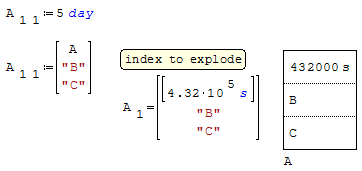

Smath Studio fails when a table containing arrays is inserted, and closes unexpectedly.
Test_Table.sm (6.37 KiB) downloaded 1160 time(s).
Carlos

may be this helps better to understand the situation here.
correction: force close occurs if the first element of matrix is a string.
table_test2.sm (23.06 KiB) downloaded 1271 time(s).

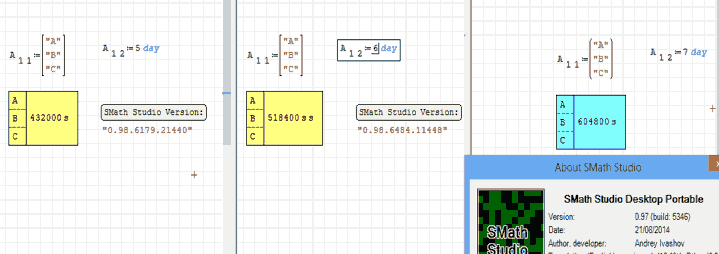

Hello "ndtm", Jean, "overlord" and Sergio.
Thank you very much for your comments, recommendations, suggestions and help.
It seems that it is a Bug in Smath Studio 0.98.6606, since I tested it in the
versions of Smath Studio 0.98.6179, 98.6484 and 0.97.5346, and in
these versions it worked correctly.
Carlos
