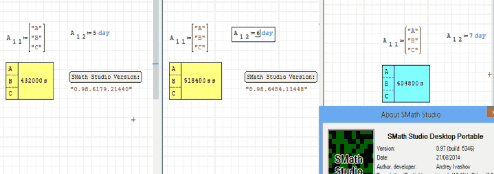

Smath Studio fails when a table containing arrays is inserted, and closes unexpectedly.
Test_Table.sm (6,37 КиБ) скачан 1159 раз(а).

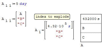

#6 Опубликовано: 06.02.2018 08:47:42
Carlos
may be this helps better to understand the situation here.
correction: force close occurs if the first element of matrix is a string.
table_test2.sm (23,06 КиБ) скачан 1270 раз(а).

Hello "ndtm", Jean, "overlord" and Sergio.
Thank you very much for your comments, recommendations, suggestions and help.
It seems that it is a Bug in Smath Studio 0.98.6606, since I tested it in the
versions of Smath Studio 0.98.6179, 98.6484 and 0.97.5346, and in
these versions it worked correctly.
Carlos
