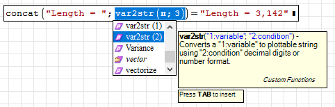

Hi, is there a way to show the output 51/500 in decimal form after concat("Length = ", num2str(L))?
#2 Posted: 2/2/2024 7:54:41 PM
1226 likes in 2151 posts.
Yes.

Thanks so much for your help, mkraska!
