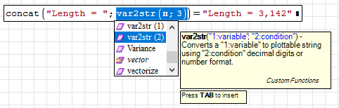

Hi, is there a way to show the output 51/500 in decimal form after concat("Length = ", num2str(L))?

Yes.

Thanks so much for your help, mkraska!
