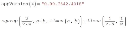

Wrote"equrep() function supports variables/functions replacements now."
Any example about what that means ?
Can you show an application of it ?
An image is good enough.
Thanks ... Jean
WroteWrote"equrep() function supports variables/functions replacements now."
Thanks ... Jean
Hi Jean. Here: Applications for equrep: expression isolation and laplace transform.
Any example about what that means?
Also, I see that this error persists:
Issue is fixed in the latest stable version I have just published. equrep() made less powerful, so it will leave an equation as is in cases where error is possible. Like your example.
This is temporary solution but it is required to continue development without serious stoppers. In future I will continue working to make symbolic engine more smart.
There is one issue with the plug-in: invalidation of the region is not requested after menu item usage (it must be done by plug-in) so borders will be visually switched only after region redrawn, f.e. after scrolling or focus in/out.
This also seems to be the cause for delayed re-draw after editing operation (you have to get focus off the image to see the changes). Very valuable hint!
Filed in the bug tracking system as SS-4640
WroteHi. Thanks! Very much!
I post that question because interpret that then equrep works replacing f by sin in this example: "equrep(3+f(x),f,sin)=3+f(x)" but now I see that the correct way is "equrep(3+f(x),f(a),sin(a))=3+sin(x)"
