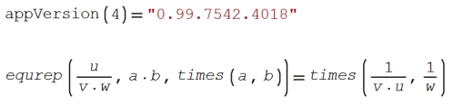

#2 Posted: 8/25/2020 6:26:19 AM
Hi. Thanks! Very much!
"equrep() function supports variables/functions replacements now."
Any example about what that means?
Also, I see that this error persists:

#4 Posted: 8/27/2020 5:11:26 PM
Any example about what that means ?
Can you show an application of it ?
An image is good enough.
Thanks ... Jean
#5 Posted: 8/27/2020 9:24:31 PM
Thanks ... Jean
Hi Jean. Here: Applications for equrep: expression isolation and laplace transform.
