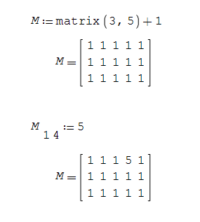

#3 Posted: 9/28/2021 8:37:33 AM

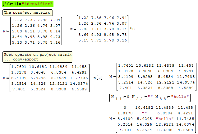

#4 Posted: 9/28/2021 9:17:41 AM
... observe the empty place holder is a / operator.

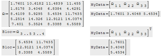

#6 Posted: 9/28/2021 11:15:31 AM
Thank You Jean, but rather, I meant to extract a specific element from the matrix.
There are many more ways ... like skinning a cat.
Cheers ... Jean.

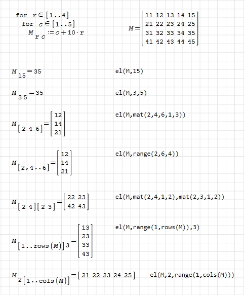

#8 Posted: 9/28/2021 4:21:01 PM
Hi. There are many different ways to access the elements of an array. This list is not exhaustive, and does not include the submatrix function.
M.sm (10.01 KiB) downloaded 1148 time(s).
