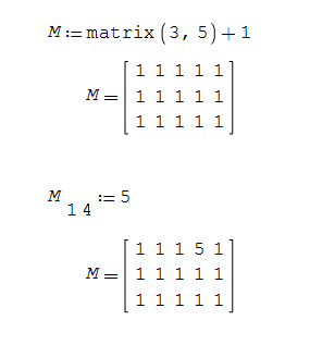

#2 Опубликовано: 28.09.2021 08:14:15
How to add specific element of matrix or table to calculations?
If you have your matrix from calculation,
simply address the element(s) with new value.
#3 Опубликовано: 28.09.2021 08:37:33

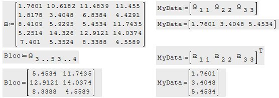

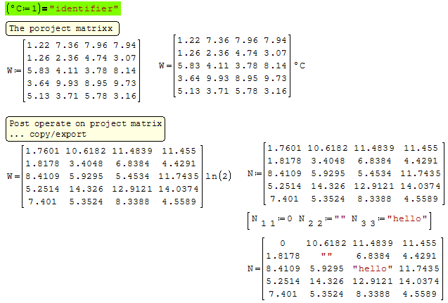

#4 Опубликовано: 28.09.2021 09:17:41
... observe the empty place holder is a / operator.

#6 Опубликовано: 28.09.2021 11:15:31
Thank You Jean, but rather, I meant to extract a specific element from the matrix.
There are many more ways ... like skinning a cat.
Cheers ... Jean.

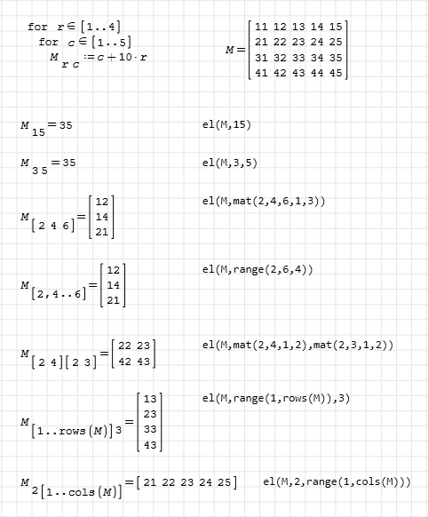

#8 Опубликовано: 28.09.2021 16:21:01
Hi. There are many different ways to access the elements of an array. This list is not exhaustive, and does not include the submatrix function.
M.sm (10,01 КиБ) скачан 1146 раз(а).
