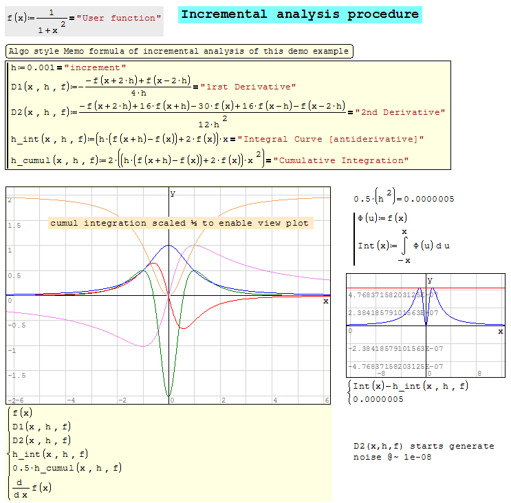

This Smath ToolBox should help developpers isolate the parts
that don't work in Smath OFFicial release(s) past 5346.
As you read, you will notice "Savitsky-Golay", a most useful
data smoother [as applicable]. I have the complete Paul W.
code Mathcad 11. Collabs interested to code in Smath, please
let me know: will attach the code. I have not attempted 5346.
Integrate Edu [Int Curve, Cumul Integration].sm (41 KiB) downloaded 104 time(s).

... read more in the work sheet of which this extract.
Integrate Edu [Int Curve, Cumul Integration].sm (49 KiB) downloaded 99 time(s).
