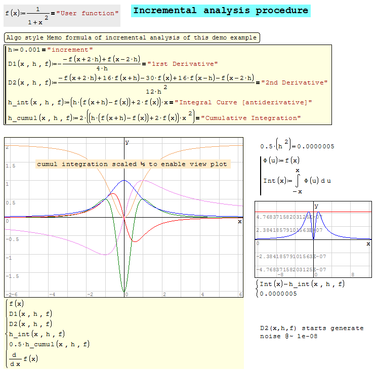

#2 Опубликовано: 22.05.2016 23:54:06
... read more in the work sheet of which this extract.
Integrate Edu [Int Curve, Cumul Integration].sm (49,23 КиБ) скачан 1283 раз(а).
