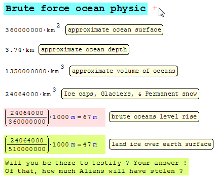

#1 Posted: 3/1/2018 1:07:45 AM
There more details not accounted.

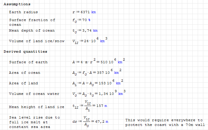

#2 Posted: 3/1/2018 4:16:09 AM
Use of units and variables -> more self documenting.
ocean.sm (10.02 KiB) downloaded 1193 time(s).
