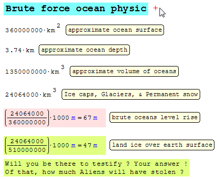

There more details not accounted.

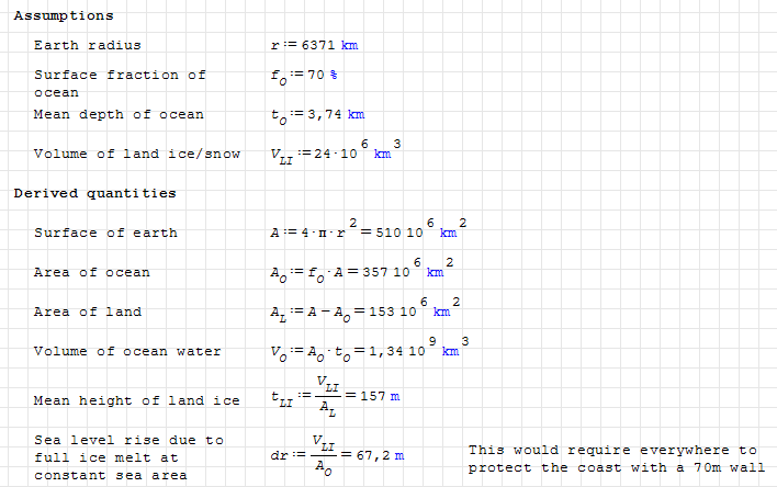

Use of units and variables -> more self documenting.
ocean.sm (10 КиБ) скачан 76 раз(а).
