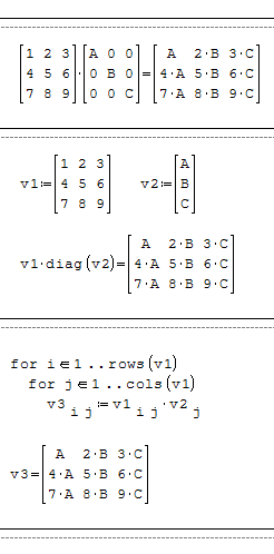

i have a litte Problem an I am not able to figure things out even with the handbook.
It seems to bee a quite simple Problem.
I got an 6x6 matrix and i want to multiply every cell of a collum with an other factor.
I am only able to multiply every cell with a factor.
Because i have a huge number of those i want to do it with a loop.
I hope my description was well enough
thanks in advance

#4 Posted: 11/17/2016 10:38:48 AM
Construct your generalised vectorising algo.
Get inspired from the attached.
Utilities Matrix Vectorise EXPRESS.sm (70.54 KiB) downloaded 1100 time(s).

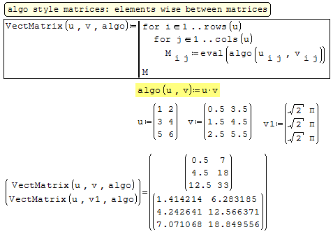

#5 Posted: 11/17/2016 12:13:49 PM
More generally:
1. accomodate rectangular systems
2. define your own multiplicand
3. assign the "algo" processing
Utilities Matrix Vectorise CreateVector.sm (12.75 KiB) downloaded 1175 time(s).
#6 Posted: 11/17/2016 9:59:00 PM
1. Refactored a bit
2. Read more stuff and examples
Utilities Matrix Vectorise CreateVector.sm (21.25 KiB) downloaded 1179 time(s).
