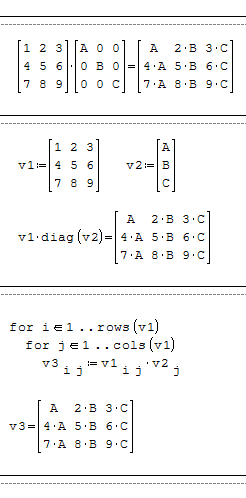

#2 Опубликовано: 17.11.2016 09:33:52
Hello [userlink]ka58642[/userlink]
ka58642 17.11.2016 10:07:00
#3 Опубликовано: 17.11.2016 10:07:16
ka58642
ka58642
Thank you very much

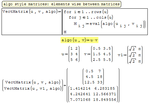

#4 Опубликовано: 17.11.2016 10:38:48
Construct your generalised vectorising algo.
Get inspired from the attached.
Utilities Matrix Vectorise EXPRESS.sm (70,54 КиБ) скачан 1101 раз(а).
#5 Опубликовано: 17.11.2016 12:13:49
More generally:
1. accomodate rectangular systems
2. define your own multiplicand
3. assign the "algo" processing
Utilities Matrix Vectorise CreateVector.sm (12,75 КиБ) скачан 1176 раз(а).
#6 Опубликовано: 17.11.2016 21:59:00
1. Refactored a bit
2. Read more stuff and examples
Utilities Matrix Vectorise CreateVector.sm (21,25 КиБ) скачан 1180 раз(а).
