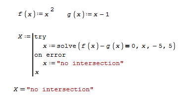

One option is as follows:
However, the error might still be due to something other than a non-intersection.

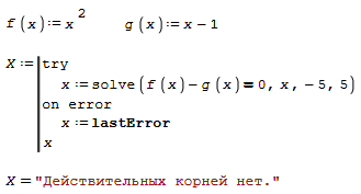

#4 Posted: 9/29/2024 3:52:29 PM
1,534 likes in 1,850 posts.
#5 Posted: 9/29/2024 5:23:31 PM
