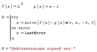

One option is as follows:
However, the error might still be due to something other than a non-intersection.

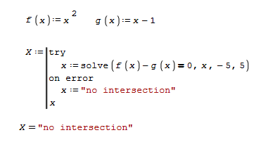

#4 Posted: 9/29/2024 3:52:29 PM
1403 likes in 1708 posts.
#5 Posted: 9/29/2024 5:23:31 PM

Thanks a lot uni, now need to put everything in a conditionally formatted label and check the type of output if is a string or a number(s) to change the displayed message.
