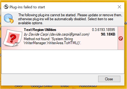

    But there is a problem with "Text Region Utilities" plugin to install.
    Davide Carpi 1/12/2017 12:17:00 PM
    #15 Posted: 1/12/2017 12:05:46 PM
    NDTM Amarasekera
    NDTM Amarasekera
    130 likes in 352 posts.
    Thank you Davide.
    The update for "Text Region Utilities" is OK now.
    #16 Posted: 1/12/2017 12:07:13 PM
    This this works fine. Thank you!
    You're welcome, thank you for reporting this issue
    Thanks again; updated both the plugins (added another small performance improvement for print preview).
