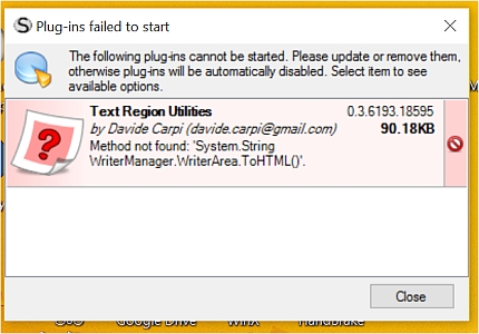

    But there is a problem with "Text Region Utilities" plugin to install.

    #15 Опубликовано: 12.01.2017 12:05:46
    NDTM Amarasekera
    NDTM Amarasekera
    Thank you Davide.
    The update for "Text Region Utilities" is OK now.
    Davide Carpi 12.01.2017 12:17:00
    #16 Опубликовано: 12.01.2017 12:07:13
    This this works fine. Thank you!
    You're welcome, thank you for reporting this issue
    Thanks again; updated both the plugins (added another small performance improvement for print preview).
