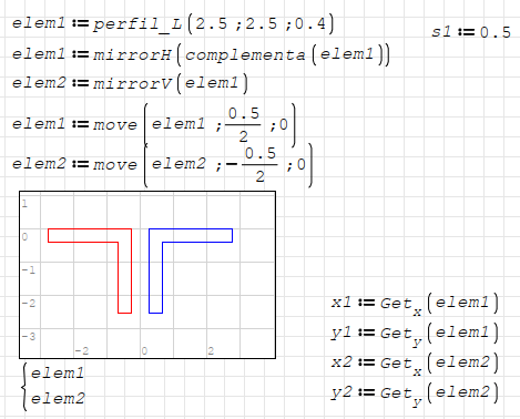

if we define a figure with its
matrix coordinates
we can use these functions to
rotate, scale, move, mirror, or offset
ToolsTransformaciones.sm (14 KiB) downloaded 111 time(s).
calculation of geometric properties
PropGeom.sm (40 KiB) downloaded 110 time(s).
functions to easily define some geometric figures
GeneradorDePerfiles.sm (168 KiB) downloaded 105 time(s).
simple example
(maybe unfinished ... I don't remember)
perfil doble.sm (13 KiB) downloaded 96 time(s).
I hope it will be useful to someone

#2 Posted: 12/14/2021 7:54:50 PM
WroteI hope it will be useful to someone
Maybe not so much if not illustrated.

#3 Posted: 12/15/2021 7:29:17 AM
WroteMaybe not so much if not illustrated.
Meanwhile, he already implemented profile plotting.
Don't mind him churichuro, he is the noodge of this forum.
This is a good example.
There is also a marvelous example written by Davide.
Check that too, it has a lot of features.
It can be downloaded via Tools>Plugins>Examples.
https://en.smath.com/forum/yaf_postst1737_PolyProperties.aspx
