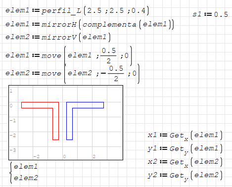

if we define a figure with its
matrix coordinates
we can use these functions to
rotate, scale, move, mirror, or offset
ToolsTransformaciones.sm (14 КиБ) скачан 113 раз(а).
calculation of geometric properties
PropGeom.sm (40 КиБ) скачан 110 раз(а).
functions to easily define some geometric figures
GeneradorDePerfiles.sm (168 КиБ) скачан 105 раз(а).
simple example
(maybe unfinished ... I don't remember)
perfil doble.sm (13 КиБ) скачан 96 раз(а).
I hope it will be useful to someone

#3 Опубликовано: 15.12.2021 07:29:17
Maybe not so much if not illustrated.
Meanwhile, he already implemented profile plotting.
Don't mind him churichuro, he is the noodge of this forum.
This is a good example.
There is also a marvelous example written by Davide.
Check that too, it has a lot of features.
It can be downloaded via Tools>Plugins>Examples.
https://en.smath.com/forum/yaf_postst1737_PolyProperties.aspx
