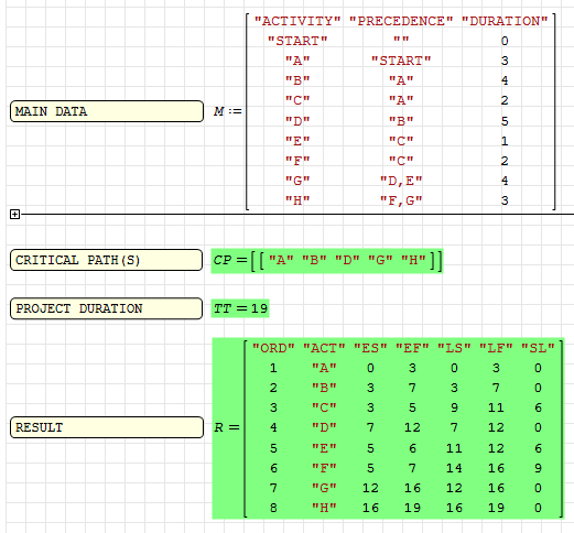

Hello everybody!
I share with you a native SMath Studio file that calculates critical path(s), early start, early finish, late start, late finish and slack for each activity.
SS version: 0.99.7813.5952
CPM_1.3.pdf (151.32 KiB) downloaded 772 time(s).
CPM_1.3.sm (43.84 KiB) downloaded 1333 time(s).
