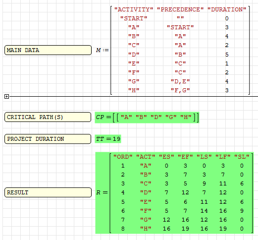

Hello everybody!
I share with you a native SMath Studio file that calculates critical path(s), early start, early finish, late start, late finish and slack for each activity.
SS version: 0.99.7813.5952
CPM_1.3.pdf (151,32 КиБ) скачан 772 раз(а).
CPM_1.3.sm (43,84 КиБ) скачан 1333 раз(а).
YouTube video about this worksheet (in Spanish): https://www.youtube.com/watch?v=S9a0Rh9llPk&t=18s

Any way to see some sort of piece-wise diagram ?
Something like a dendogram ?

That would be great! I dare not do such a task.
#4 Опубликовано: 24.05.2021 15:44:15
BTW, we have dendogram Mathcad 11 ... scared to dare coding !
Maybe your friend Alvaro [Razonar] is willing this challenge.
Take care Alvaro ... Jean
