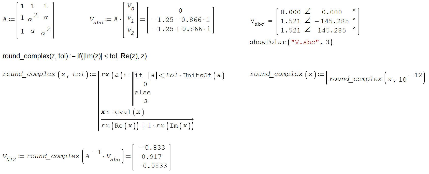

I am one tiny step away from freeing myself of Mathcad Prime. I just need to know how to format the result of a matrix/vector operation so it is in polar form with angle in degrees. The attached image is a snip from a Mathcad result. How is this possible in SMath?

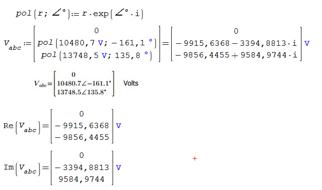

Thank you. That does not address formatting a vector result in polar with degrees (what I'm after) as best I can tell. I want to display my resulting vector in polar with degrees.
Also, I tested the "pol" function and it assumes the angle is in radians.
Worksheet1.sm (10.64 KiB) downloaded 1016 time(s).

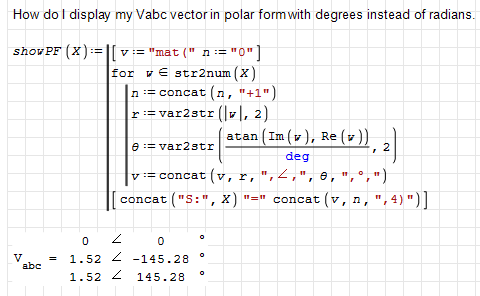

#4 Posted: 10/14/2025 9:09:21 AM
Hi. You can try something like this, using the table plugin.
showPolarForm.sm (18.3 KiB) downloaded 1050 time(s).

#5 Posted: 10/14/2025 6:04:28 PM
Russ Patterson
Russ Patterson
0 likes in 5 posts.
Thank you. That works rather well.
1) Is there a way to hide that showPF function at top of my worksheet?
2) I can't figure out how to make it report a very tiny imaginary component as zero. See bottom of attached. showPolarForm.sm (20.74 KiB) downloaded 1086 time(s).
best regards,
russ
p.s. It would also be great if we could control the table borders at an individual column level - so I can make it look like brackets around the results.

Hi. Modified version.
showPolarForm.sm (21.93 KiB) downloaded 1106 time(s).
sergio 10/15/2025 5:42:32 PM, Russ Patterson 10/15/2025 8:51:43 PM
